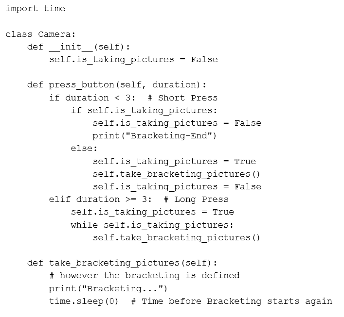

photographing the solar eclipse is a kind of lucky HDR imaging. You never know beforehand how the light will refract in which lunar crater, so you take hundreds of series shots and select the best scenes. I understand that it will be a niche application and it makes little sense to program your own Eclipse mode. This is where the bracketing function could actually be a suitable workaround. I tried it out today a 10-stop HDR in TV mode starting @ 1/8000s takes less than seven seconds. Unfortunately, there are no loop functions, as with the Timelapse or Holy Grail mode. This means you have to press the button again and again. Perhaps it would be possible to implement a kind of long press function to restart the bracketing over and over again. An Easter Egg is warmly welcome😊. Something like:
import time
class Camera:
def __init__(self):
self.is_taking_pictures = False
def press_button(self, duration):
if duration < 3: # Short Press
if self.is_taking_pictures:
print("Bracketing-End")
else:
self.is_taking_pictures = True
self.take_bracketing_pictures()
elif duration >= 3: # Long Press
while self.is_taking_pictures:
def take_bracketing_pictures(self):
# however the bracketing is defined
print("Bracketing...")
time.sleep(0) # Time before Bracketing starts again
This code performs the recording series once when the release button is pressed briefly (like today) and repeats the bracketing series continuously when the release button is pressed and held for >3 seconds. Another short press of the release button ends the continuous bracketing series. Just as an Idea how it could be implemented. The attachment is easier to read as tabstops doesn't seem to work in the chat.
BR,
Knud
![Image]()
