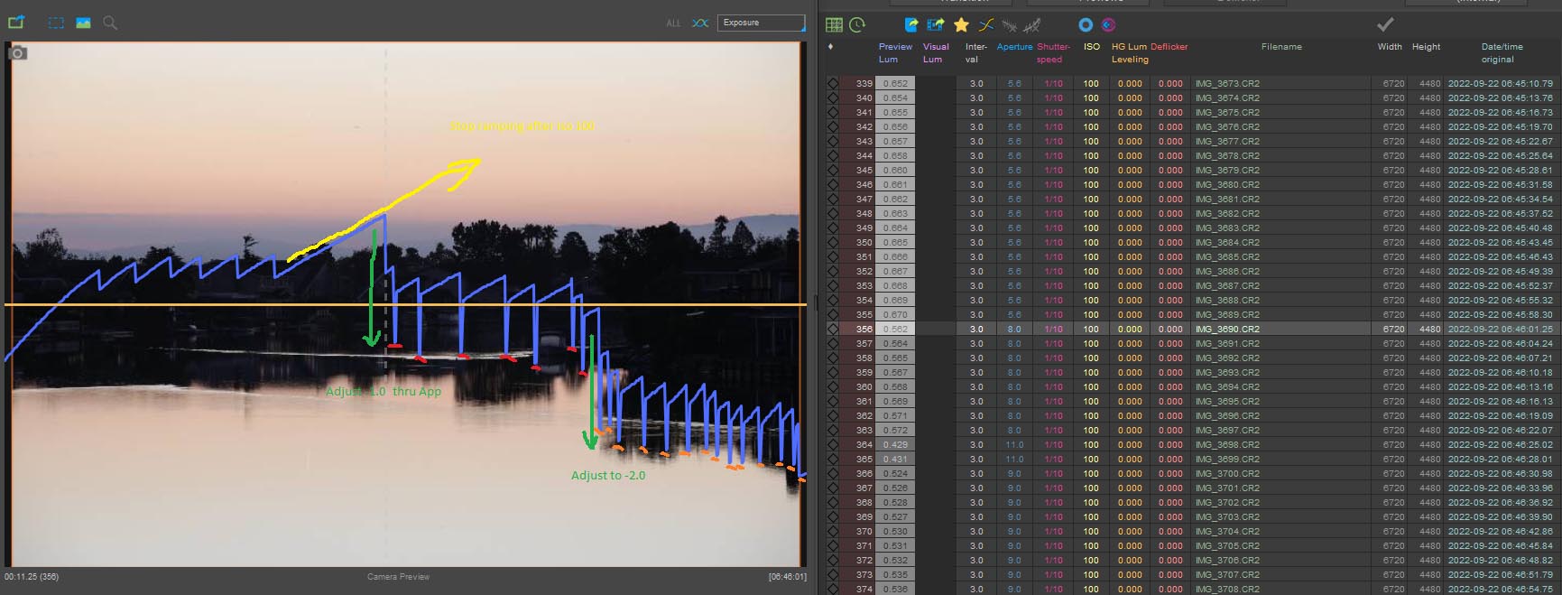

As I said in the email, I did another sunrise session with the EV 24h algorism this morning. Unfortunately I got a similar issue. Now it always drops one full stop to the adjusted meter value:
I started with an exposure of iso400, f5.6, 1/10 (one stop lower than the camera metering value). At first, the ISO was ramped from 400 to 100 without any issue, then it stopped ramping(see the yellow line). I made the adjustment to -1.0 manually in the App to lower the exposure. Then the ramping started again, and the problems showed up:
The exposure kept going up about 1.3 stop higher than the adjusted value, following by an one stop sudden drop.
The Red dots are the adjusted -1.0 EV points, and the orange dots are the -2.0 EV points that I set at the two green lines respectively. It supposed to ramp to these red and orange dots within 1/3 stop.

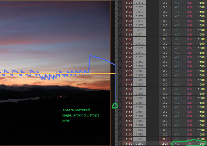

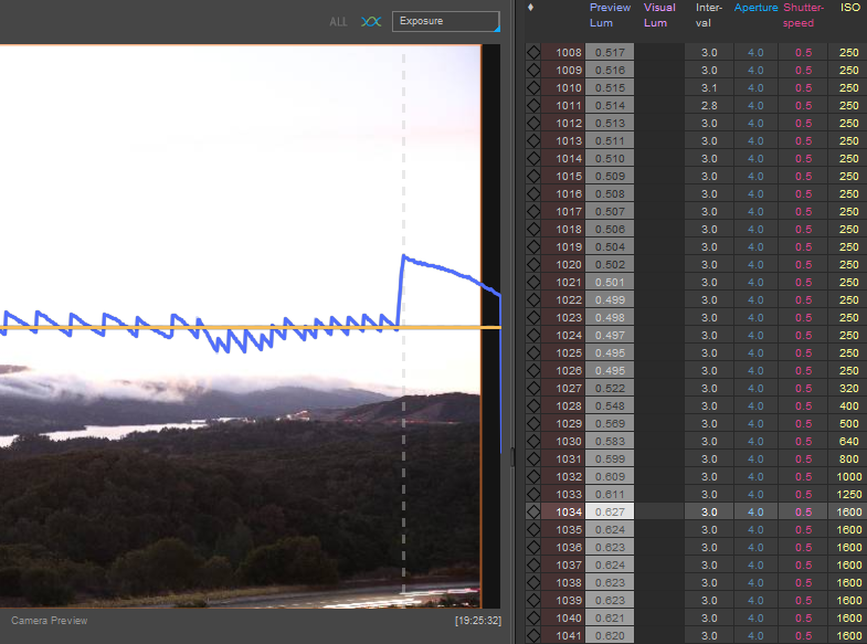

Well, unfortunately my sunset sequence today was ruined again with you new firmware A2.2.3,
iso spikes.png (198.82 KiB) Viewed 193636 times
The iso jumped from 250 all the way to the night limit, 1600. Way over exposed (3 stops higher than the camera metering):
Over exposed.JPG (87.16 KiB) Viewed 193636 times
