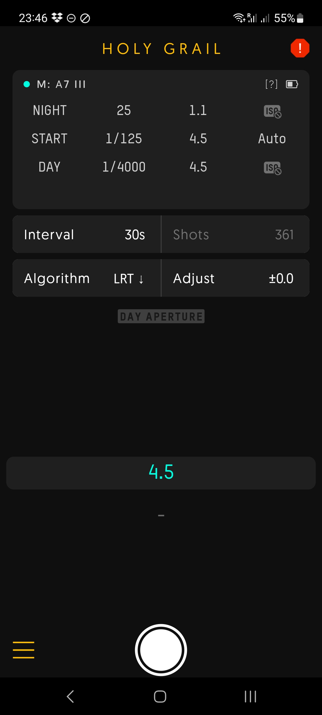

Could you share a screenshot of your settings in the holy grail screen, especially the view when you tap on "Show limits >"?

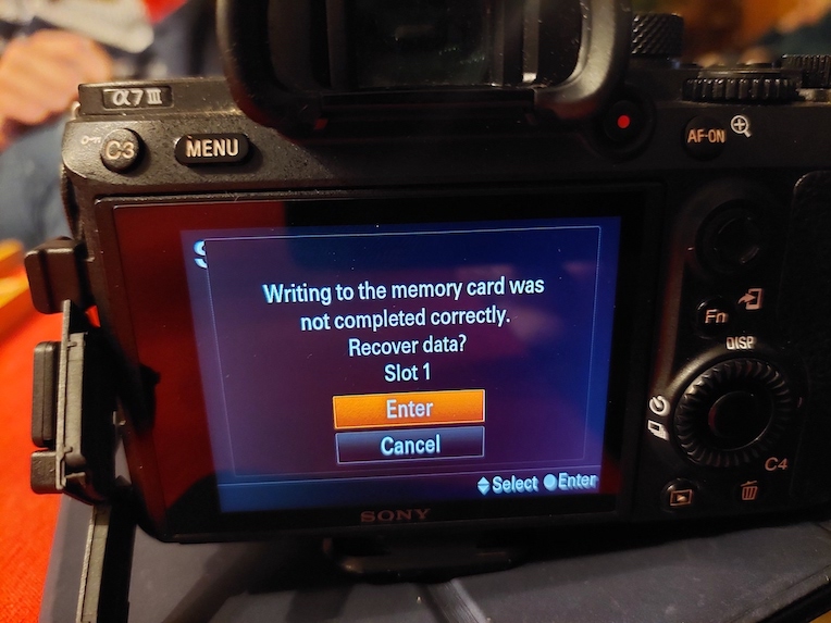

So, we have done a little research on this today.
1) Here's some background: Unlike the other brands, Sony (as well as Fuji) don't allow access to the SD card via USB, unless you change USB modes in the camera menu. However, they do allow access to the photo in the camera's buffer, but what's worse: they REQUIRE access to those photos in most cases. This means that we have to handle the photos as they're being saved to the buffer, or the camera won't allow you to turn it off - resulting in the "stalled" camera you describe, which can only be fixed by unplugging the camera battery. You can also unplug the Unleashed, by the way, which also solves the issue in most cases.
The camera does have a setting which tells it to save the photo both to the SD card and to its buffer for the USB host to fetch it. on Sony this setting is called "Still Img. Save Destination". It's very important that this is set to save to "PC+Camera"
We can handle the photo in the buffer, either by downloading it, or deleting it from the camera buffer, (again - this is independent of it being saved to the SD card). Unfortunately, Sony doesn't always tell us whether there's a new photo in the buffer, especially when you take more than one photo, so it's very tricky to figure out that we need to delete a photo if we don't even get told it exists. This is further complicated when the photos are actually needed for transferring to the app, and for using in the LRT Autoramp algorithms. I think we've figured out a solution today, and will hopefully have it implemented in the next day or two. It will be part of the next firmware update.

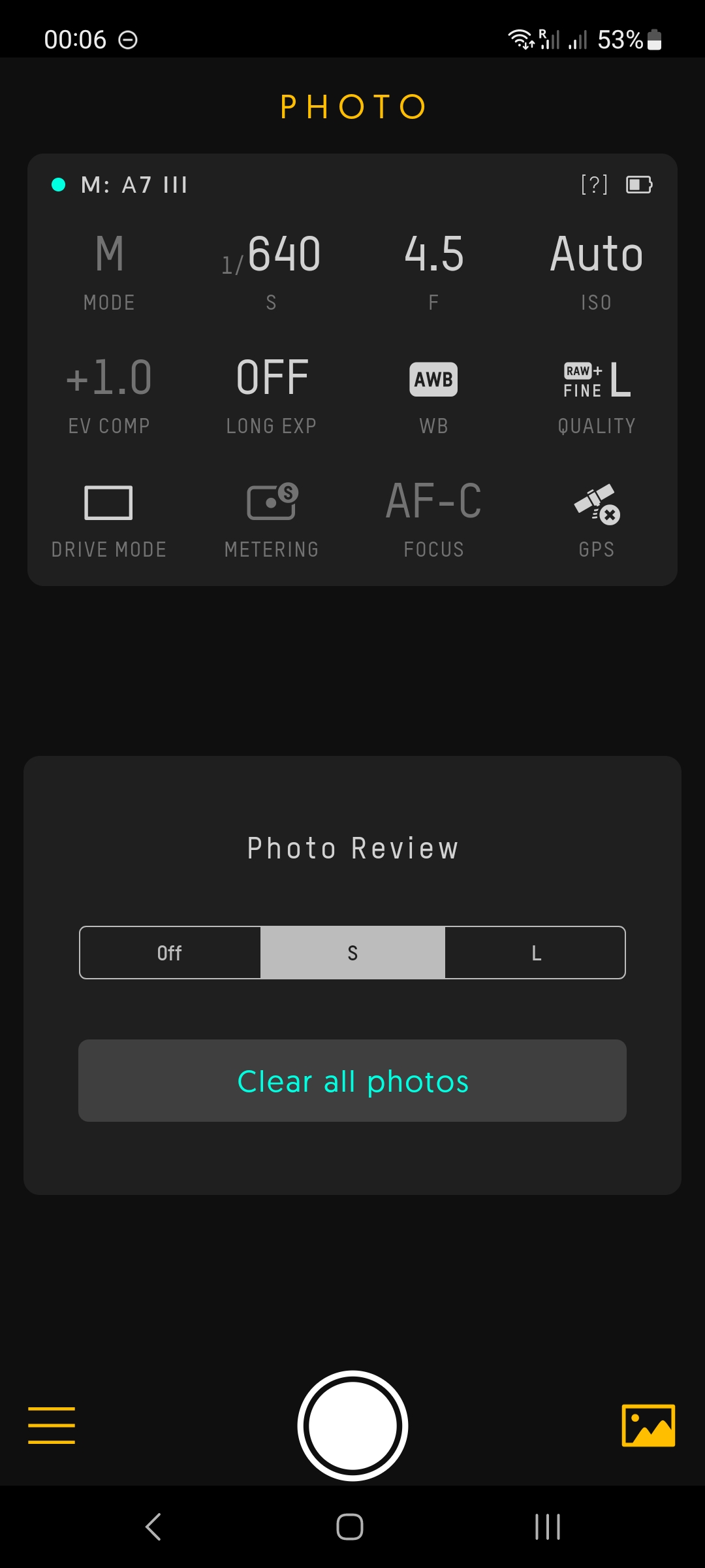

unleashed1.jpg: photo settings in the app
unleashed2.jpg: the error message on the camera, after the photo was taken and I think it restarted (see video)

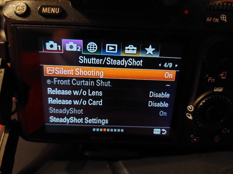

unleashed3.jpg: Settings before shot. I had just changed silent shooting to ON

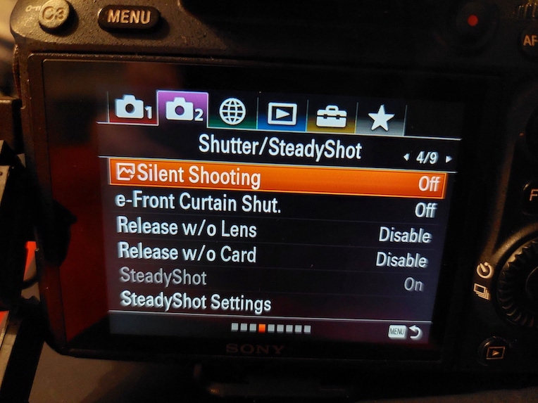

unleashed4.jpg: As you can see, the silent shooting has been reset to OFF after the process.

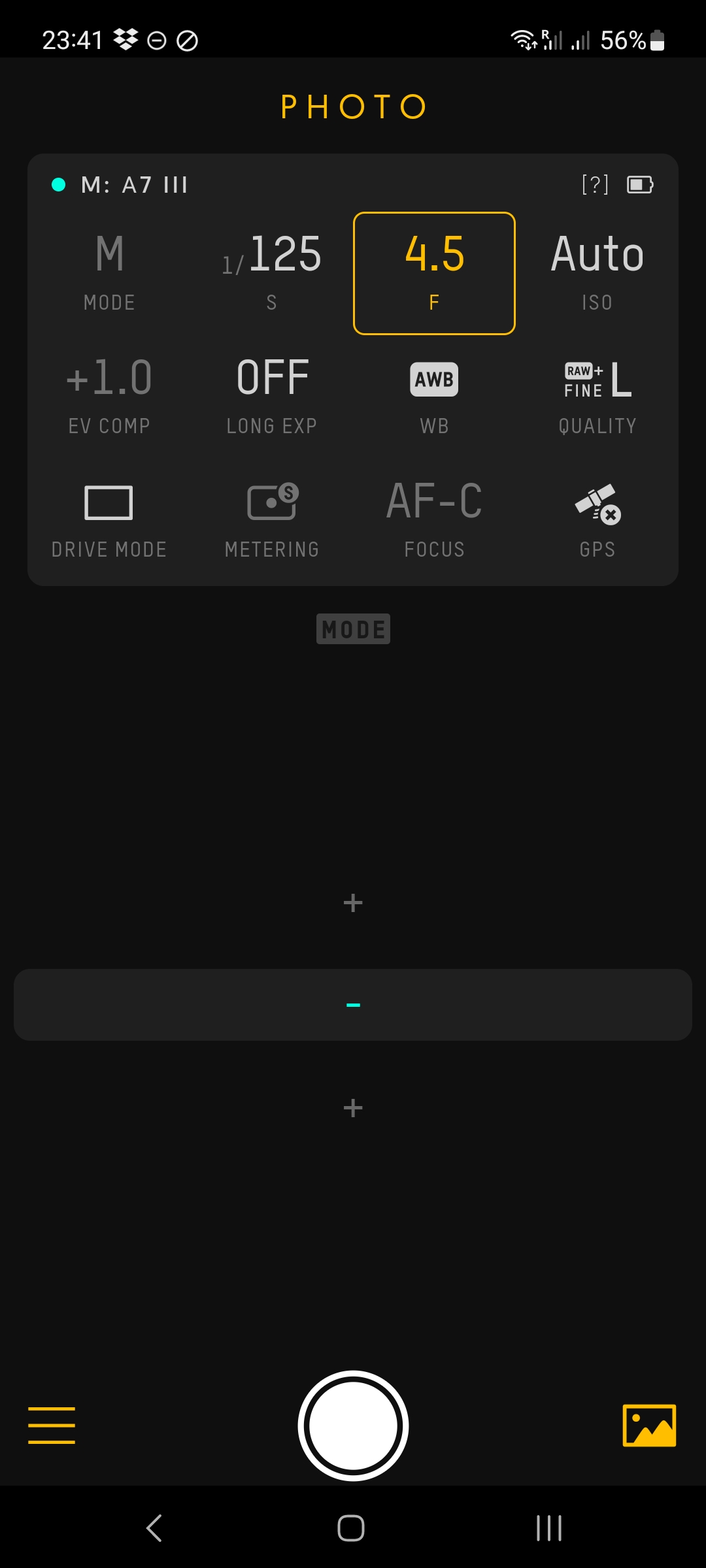

>>>3) Good catch - this is because this set of Sony's doesn't tell us the available Aperture values, and we can only adjust by + or - 0.3EV at a time. Because of this,
>>>we set the normal Aperture options to just + and -, and then reuse that for Day and night limits for Autoramping. You're right that this doesn't make sense. We'll
>>>allow setting apertures from f/1.4 to f/32, and you'll need to select aperture limits that your lens can actually handle, or you'll throw off the results. Again, this is
>>>a limitation only of the Sony cameras from 2016-2019. Newer Sony's and all other brands don't have this kind of limitation.
That's odd, because again Arsenal can do this and reports the aperture values correctly, so it seems possible one way or another.
Anyway, even if not, I find the design of the app unfortunate here. With using the same scroll list design used everywhere else, it looks bugged (e.g as if values are not displayed, but a scroll selection list is indeed intended), rather than the behaviour you describe.

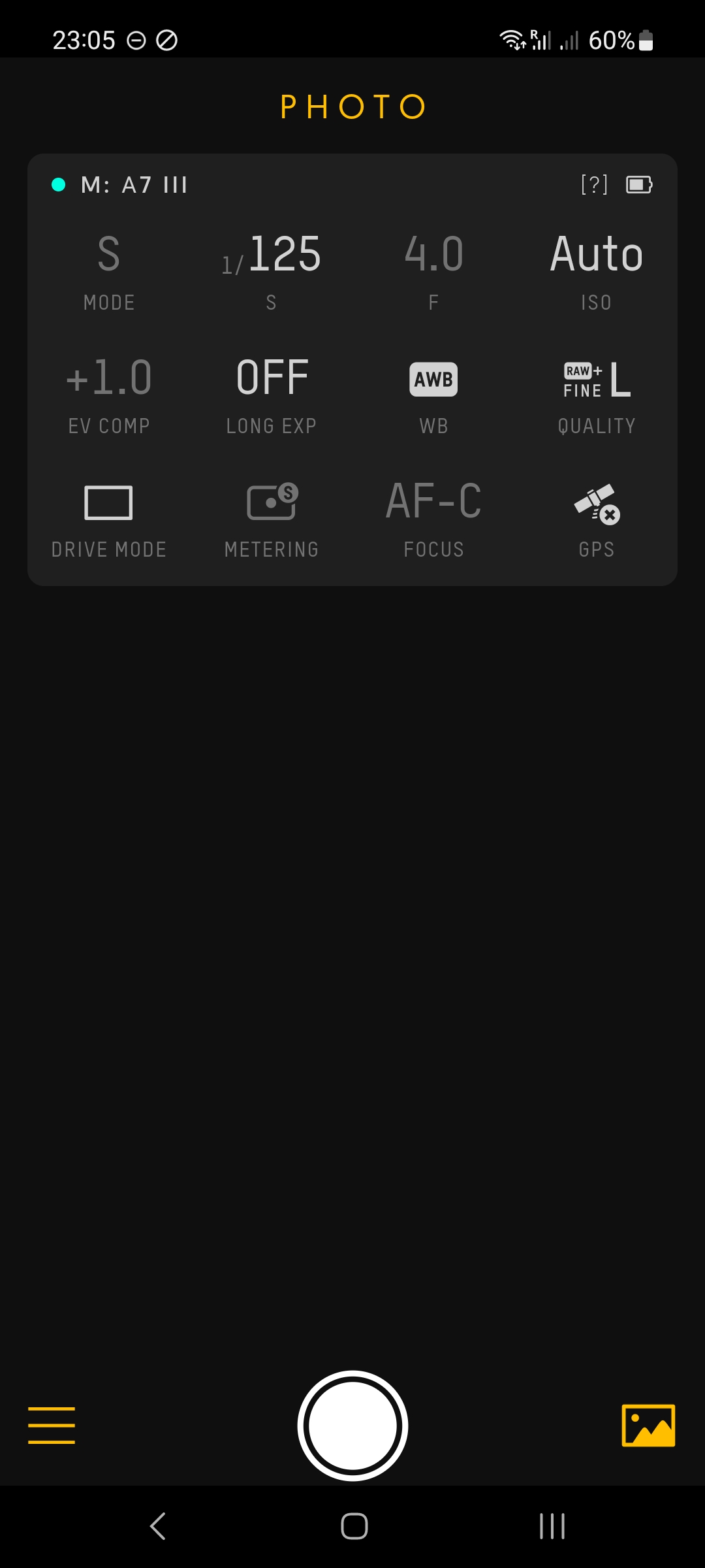

It doesn't only say + and -, but actually there are 3 options (unleashed5.jpg). Maybe it might be better to design just 2 buttons that say +0.3 and -0.3 instead?
That would make the GUI more intuitive if the values themselves can indeed not be displayed.
The behaviour in the app is also not the way you describe. With this lens (Sony FE4 24-105 G OSS), the aperture is set to 4.0 if the app is on + (either of them), and on 4.5 when it's on - . I can not repeatedly click the + or - to change the value beyond those values (4.0 being the minimum, of course).
This behaviour is indeed different in the holy grail timelapse option, where the options shown are different (unleashed6.jpg, unleashed7.jpg), but at least on the larger limit, it offers 1.1 which the lens doesn't even do. On the night, I can only select 1.1 and 4.5 (current value on camera), on the daytime only 4.5 and "-" (which I have no idea what it actually does/sets)

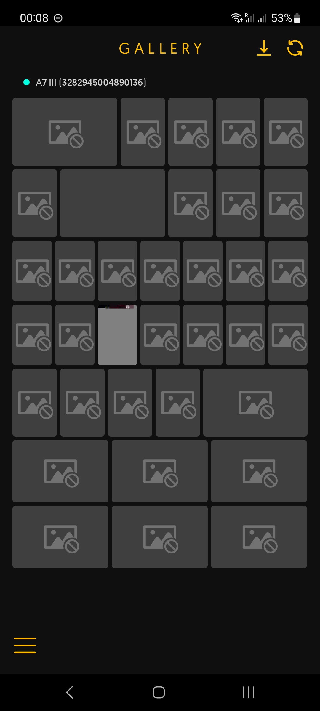

>>>6) But you can show images in the app! Not Live-view - there is simply not enough bandwidth on Bluetooth Low Energy to make this a pleasant experience, but you
>>>can get image previews onto the phone in the PHOTO screen in the bottom right corner! You might have some limitations there due to 1), but generally this works!
the bandwidth argument might be true. Such a shame, but not a deal breaker for me. I like it in the app, but it's not critical.

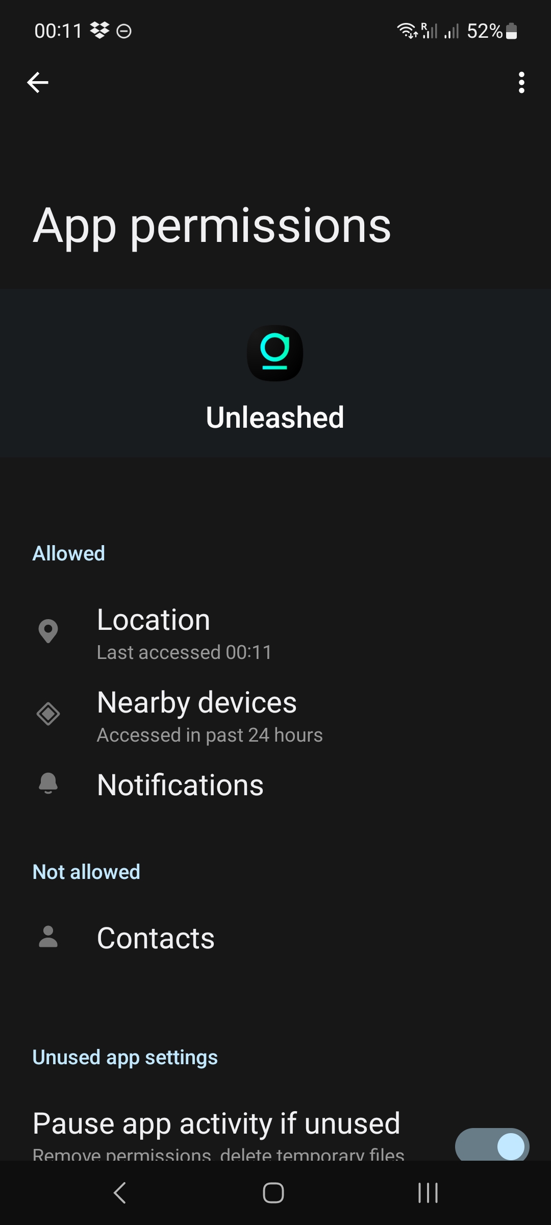

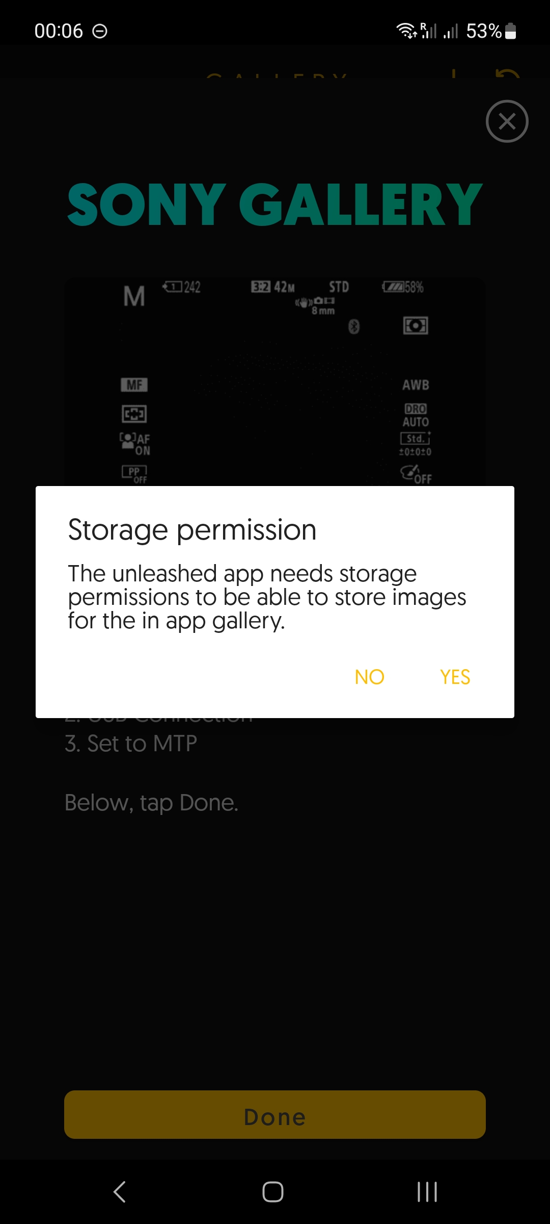

The photo screen doesn't work on my app. although I have it selected that images are shown (unleashed8.jpg, after I tapped the icon you mentioned, unleashed9.jpg)
And the gallery feature also doesn't work either. a) it requires storage permission on the phone (unleashed10.jpg) which I can not actually give (unleashed11.jpg), and b) even once this is done, one has to change the USB connection type on the camera to MTS by hand (which is cumbersome) and yet the images are still not displayed (unleashed12.jpg).
So I can not find any way to view the images in the app, no.

In the worst case, I need to take out the battery (or possibly unplug the unleashed). This means a hard reset in the camera, e.g. any changes done in the settings since last switching it on are lost, because seemingly the camera only saves those settings at shutdown.

We published an Android App update that solves the Android 14 and Storage Permissions,
as well as a some firmware updates that fix the Sony issues. You might want to delete the App and reinstall it to start Gallery over (and get rid of any corrupt images)
We added some more important instructions on our Getting Started page
Set the file format to RAW+JPEG (or just JPEG), There are significant disadvantages with just RAW
Set the camera setting: MENU > Setup4 > USB Connection = PC Remote
Set the camera setting: MENU > Setup4 > USB Remote Settings > Still Img. Save Dest. = PC+Camera
Set the camera setting: MENU > Setup4 > USB Remote Settings > RAW+J PC Save Img = JPEG Only
Get the App update on the Play Store, and update your firmware. Whenever there's a Firmware update available, you'll see a red notification badge on the menu icon in the bottom left corner of the app. Follow this notification badge through the app to get to the firmware update screen.
