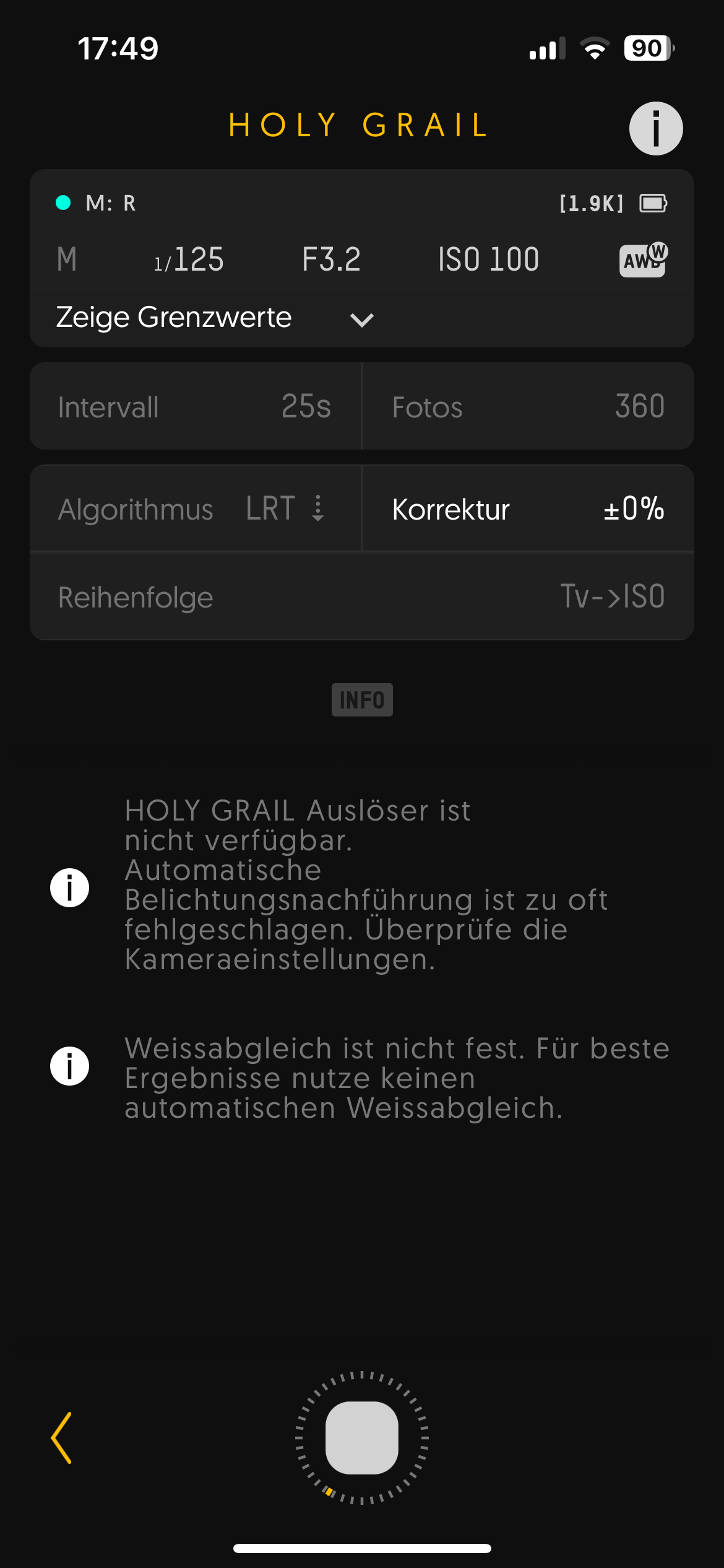

When trying to shot a Holy grail, I get this error message in the Unleashed app:
Error in english: HOLY GRAIL not available, automatic exposure setting failed too often.

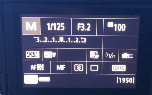

My camera is set to manual mode, manual AF, RAW only:
What is the problem? Latest Firmware updated today.
Never had a problem when shooting HG with qDSLR and these camera settings.

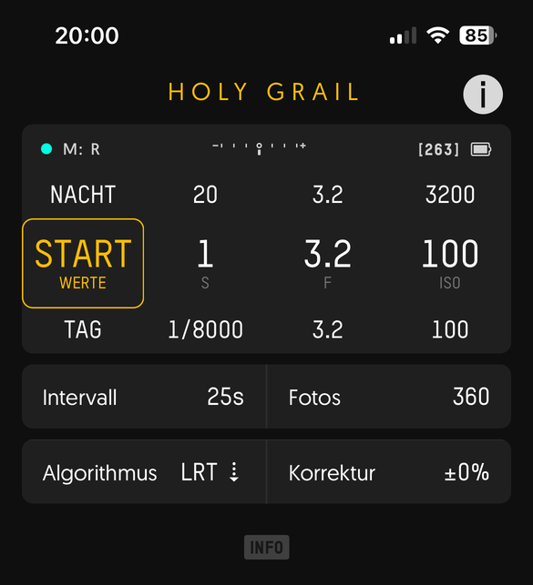

February 25th, 2024, 8:04 pm
Here the complete setting. But why does the day setting matter when making a sunset holy grail?
