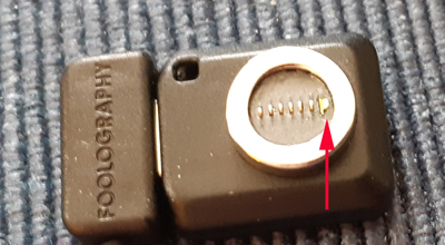

OK, the replacement unit arrived after being stuck in Norwegian Mail & Customs for three - 3 - weeks.
First, I noted that one of the pins of the M was looking strange (arrowed below)
Next, I put the replacement unit on the Z f and hoped for the best. I had to update the firmware to the latest 3.21/3.10 version which for once went smoothly. Then I paired the Qstarz as accessory and crossed my fingers.
