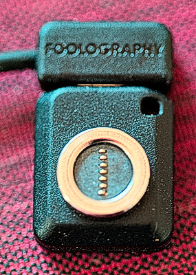

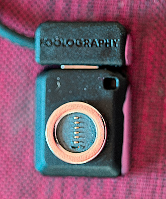

The company finally decided to refund my '22M, which I bought after the Kickstarter project. That leaves me with the '22M from the Kickstarter time, which I cannot get refunded. Thus I'm stuck with a defective unit that only has a single reliable function, viz. to rapidly drain the battery of my camera. For this 'feature' I have paid hard-earned money.
I have had a closer look at these units, and it is plainly obvious that the build quality is abysmal. Thus, not only do we have to struggle with the crappy and buggy software and firmware, there is also malfunctionality built into these devices. The advertising blurb about 'German qualitity' is pure nonsense,
The construction issue is with the contacts for the magnet USB pin. The contact pins rapidly begin to come out of alignment, moving laterally, or even fall out. Examples are show here, below. NB: these are different units. In addition, I have returned, and got replacements, for non-working device twice. One of the replacements went to a very early grave, whilst tte other might work for a few minutes if it is tired of draining my camera battery. However, it's the latter task it excels in, and also prefers.
Was there any field testing of this design before it went into production? Quality control apparently is non-existent. I have received 3 out of 4 units with hardware errors, and a fourth unit that is malfunctioning, although no pins have fallen out -- yet.
