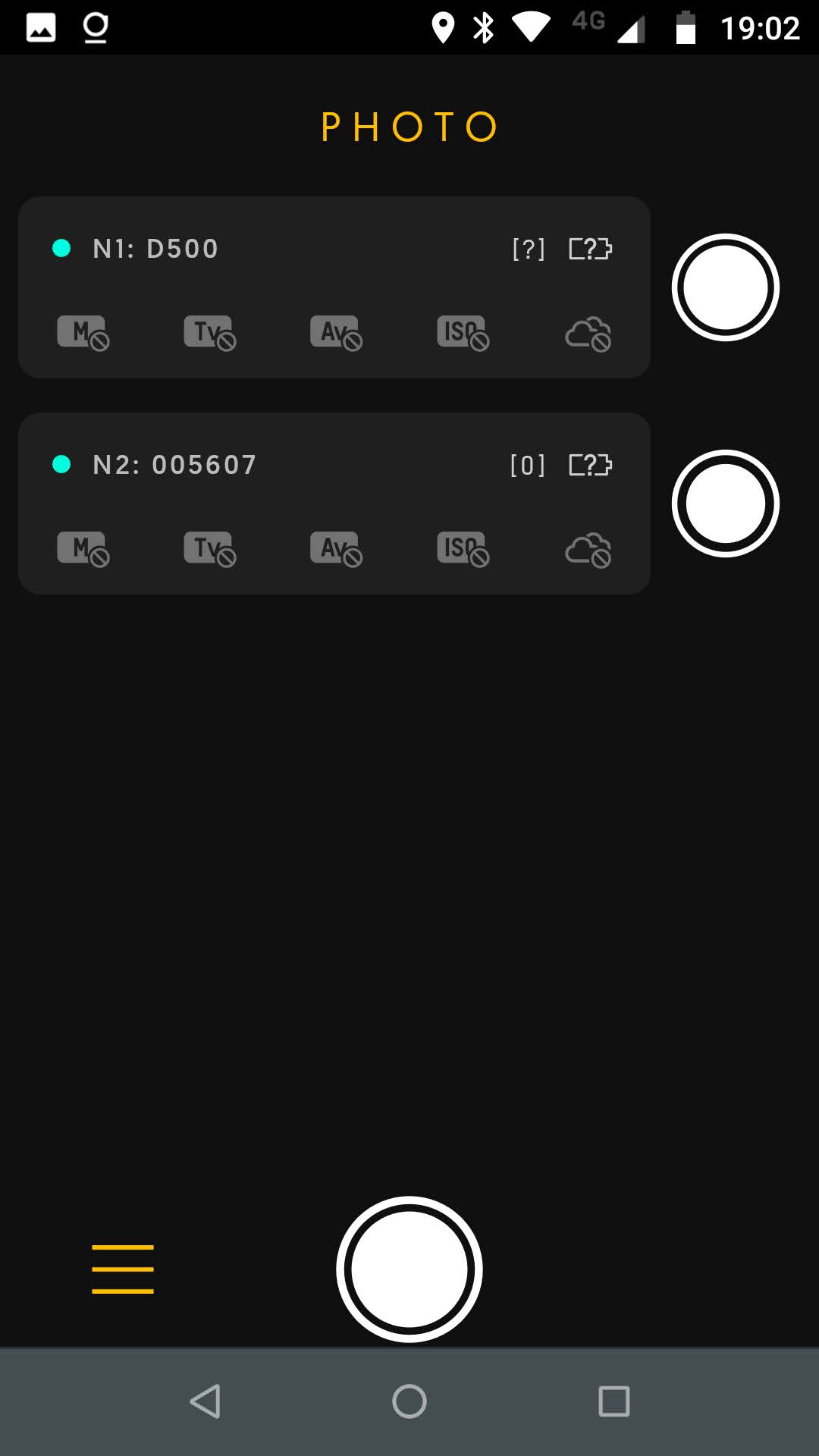

May 30th, 2021, 5:36 pm
That's not expected.
Is the USB cable also unplugged from the Unleashed? or just from the camera?
can you send me a screenshot of the PHOTO screen in the app?
BartTroost
Posts: 5
Joined: January 7th, 2021, 10:30 am
May 30th, 2021, 5:49 pm
The usb-cable is totally removed from camera and from unleashed.
Here the requested pictures:
May 30th, 2021, 6:03 pm
It looks like the shutterbutton of the camera is half-pressed in the screenshot. (compare the size of the inner circle of the shutterbutton between D500 and Z 7II)
This could be a short inside the Unleashed, for example if moisture got in the Unleashed and a bit of corrosion is bridging two contacts.
can you observe if that changes when turning the camera off and on?

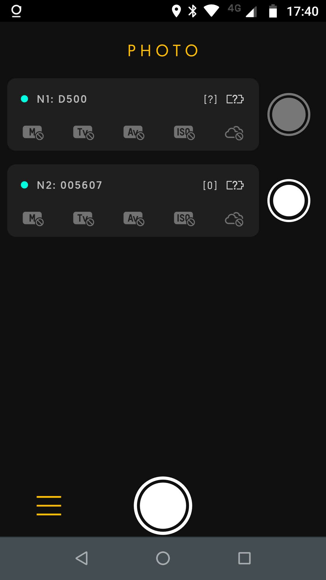

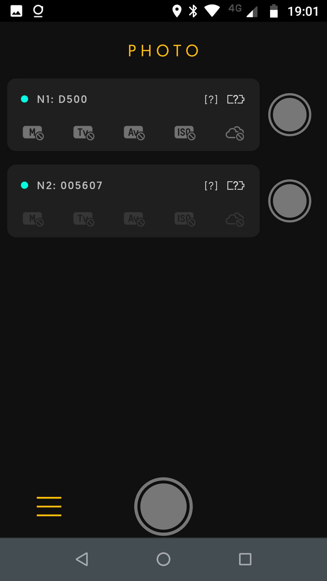

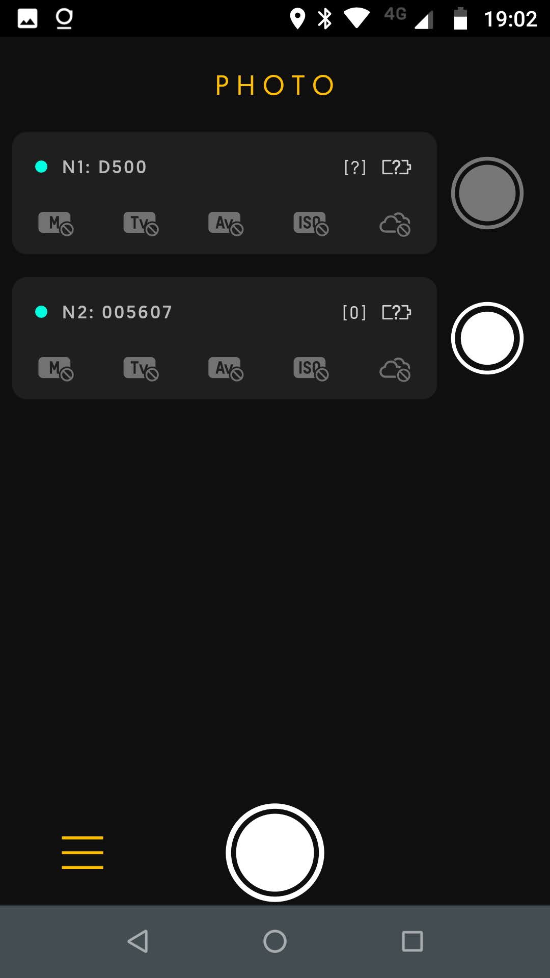

BartTroost
Posts: 5
May 30th, 2021, 7:29 pm
I see what you mean. I have 3 consecutive screenshots:
1. D500 power off; Unleashed reinstalled on Z7 II; still power off
2. Z7 II power on
3. D500 power on
I see the difference between the two
