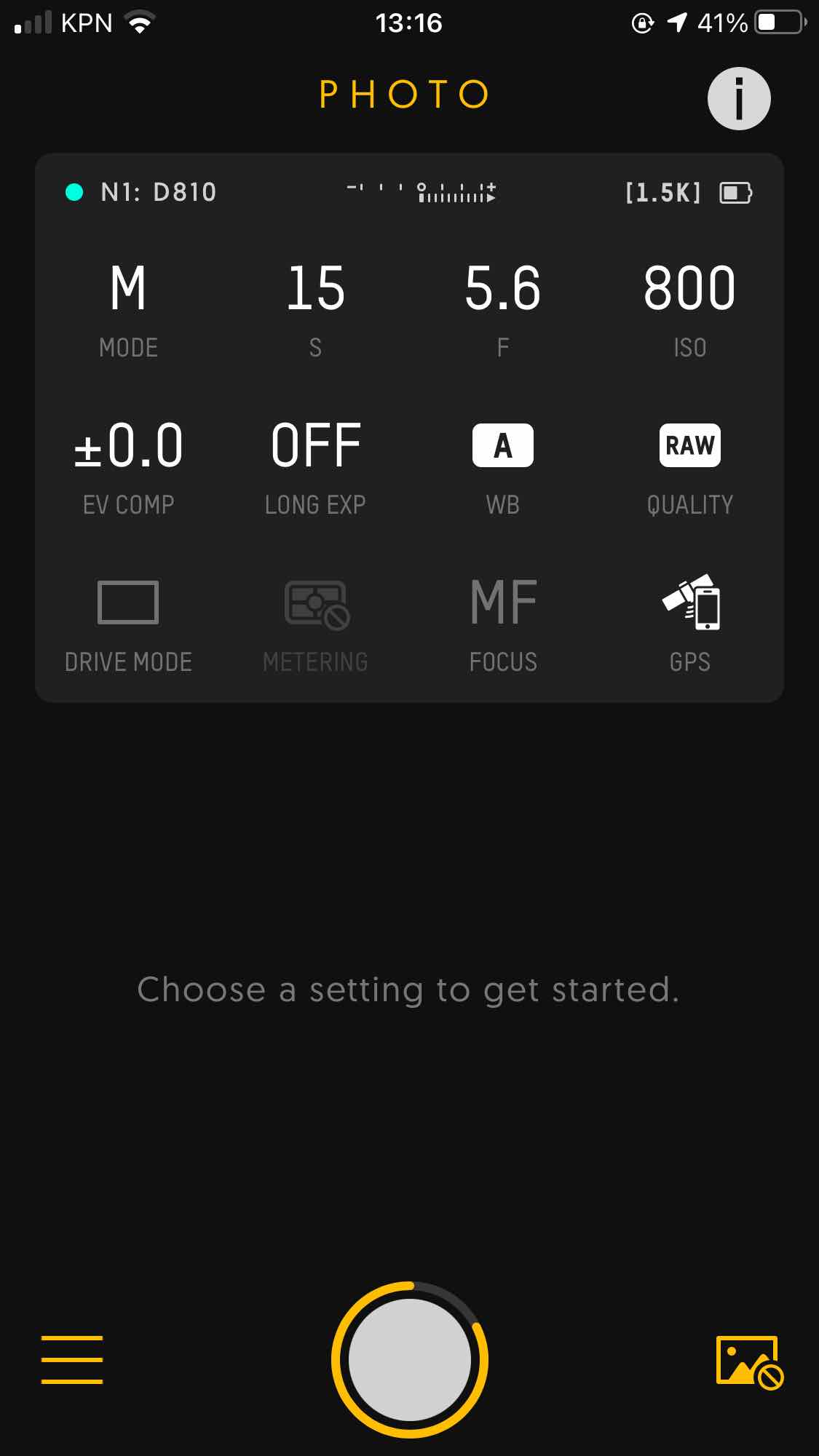

Test setup as requested: camera shutter speed 15sec.
I start the APP and D810 is connected. GPS mode in APP off.
I press the shutterbutton I see a yellow ring around the shutterbutton (counting down). (see screen copy)

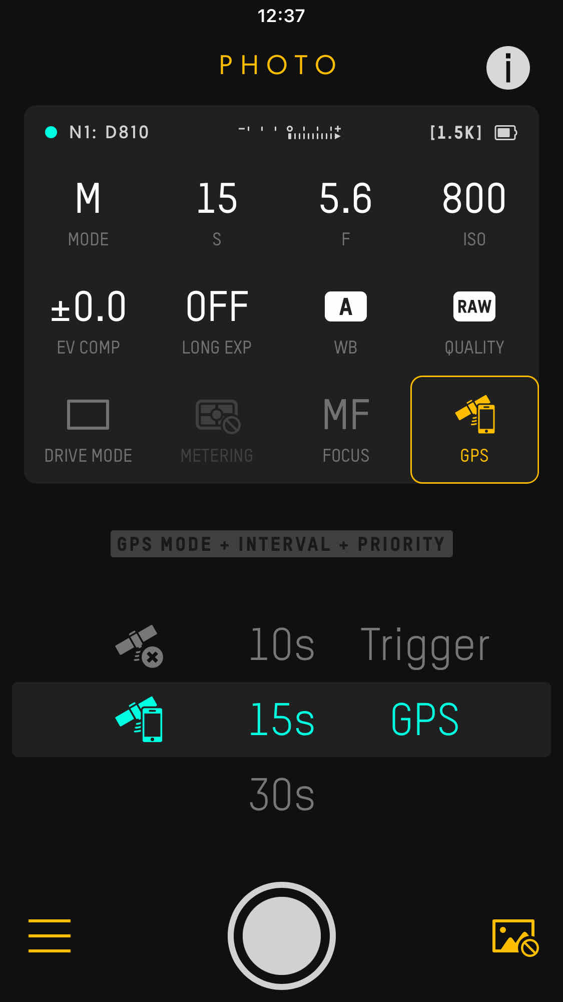

Now I set GPS ON and select 15sec GPS. GPS Icon in APP is yellow.
When I press the shutterbutton nothing happens I see a "I" in the right upper corner.

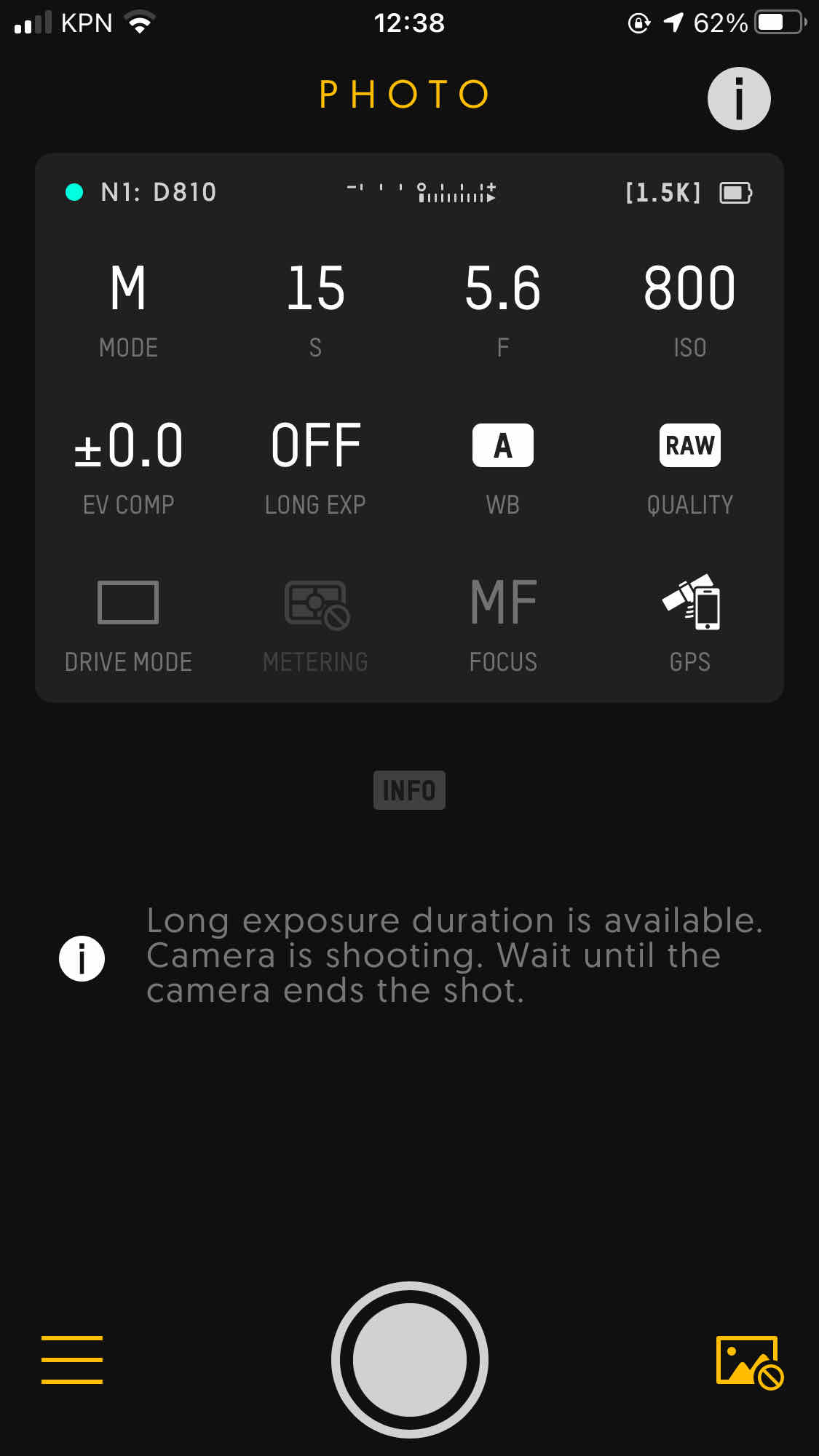

Pressing the "I" I got a msg "Long exposure duration..... Wait until the camera ends the shot.
But the shutter in the camera will not released and can I wait for hours without making any picture.
This is a False msg that the camera shutter is released.

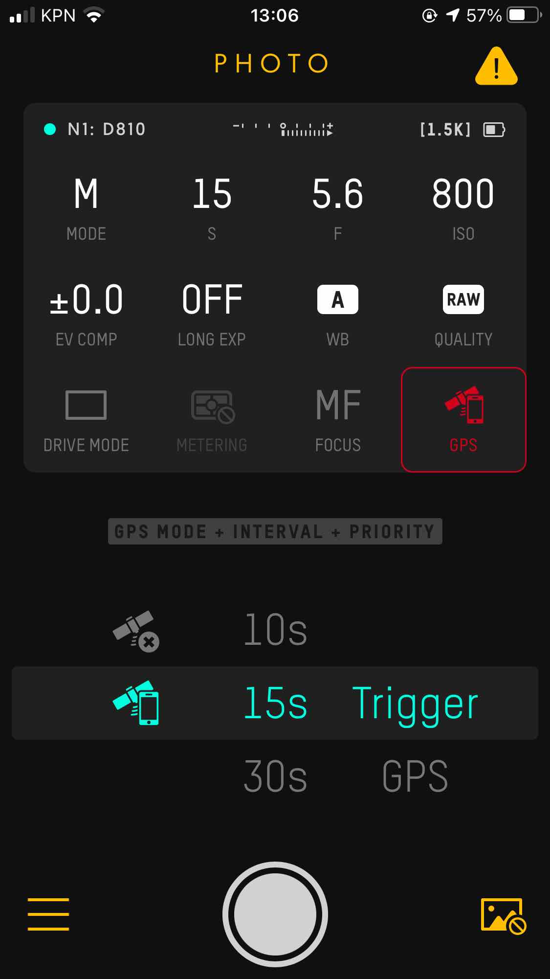

At that moment, when the APP is thinking about a long exposure duration I change the mode from "GPS" in "Trigger" and the camera starts directly with a 15sec. duration (without pressing the shutter release button).
The APP knows that I have pressed the button (in GPS mode) and released the shutter directly when I change from GPS in Trigger mode.

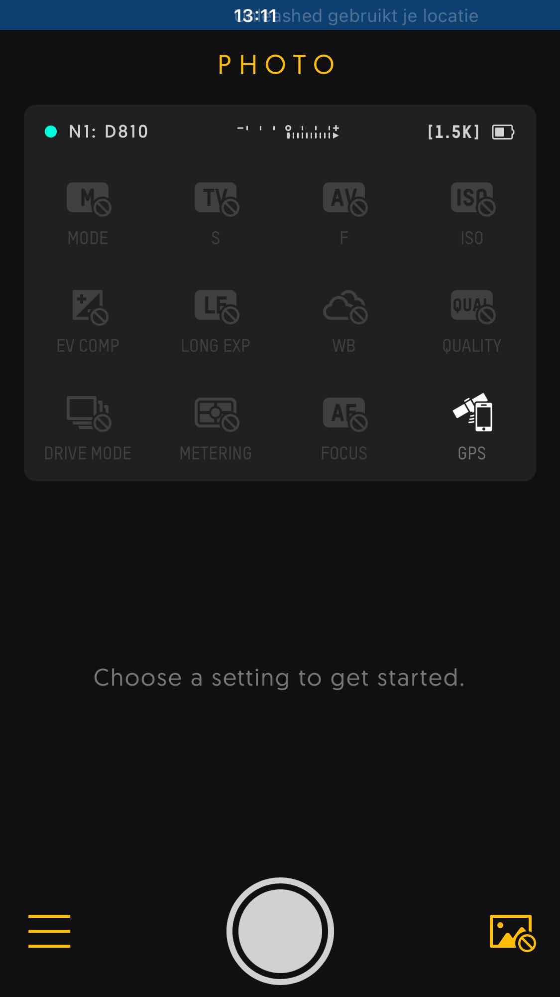

When I start the app I can see for a very short period (1sec.) a Red GPS icon and changing from Red to White. I suppose that Red is no GPS signal and White is a good GPS signal.
When GPS is on and set for e.g. 5 sec. I can see every 5 sec. a bleu row at the top saying that myblocation is used by the App.
