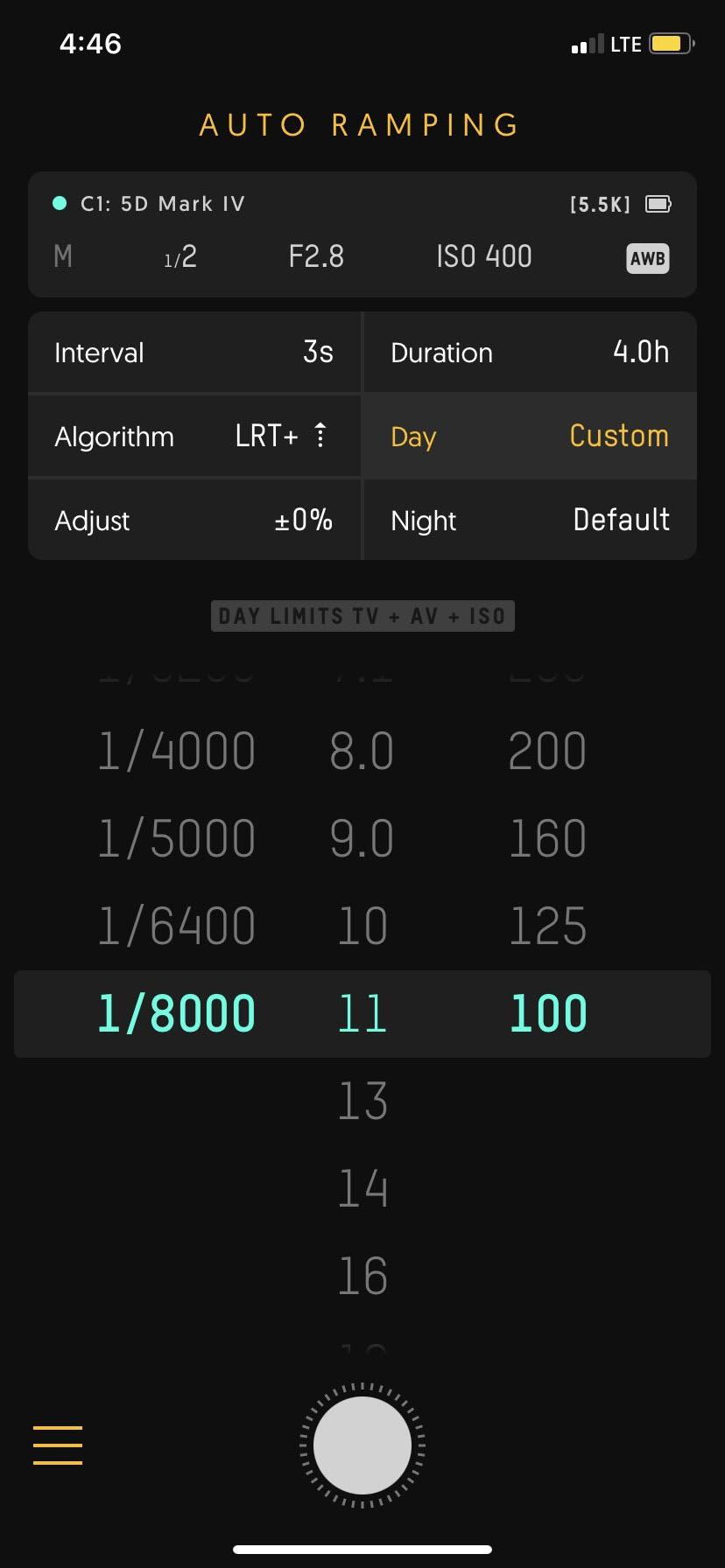

Init settings, starting with 0.5sec

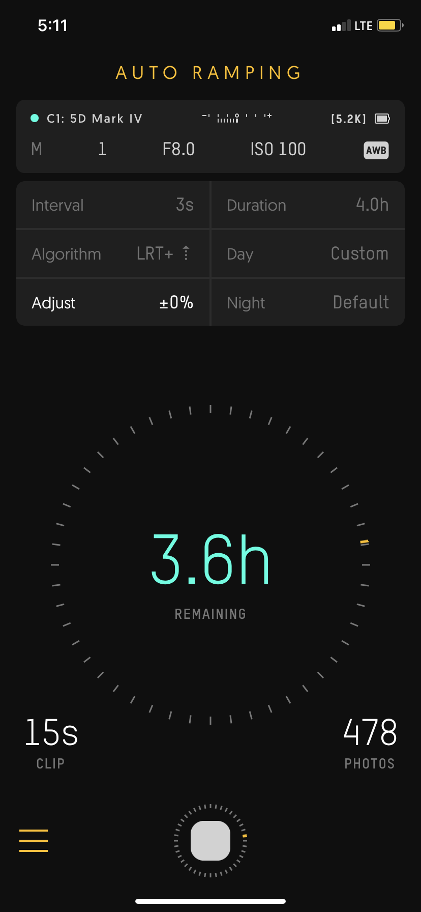

5:11am, shutter jumped to 1 sec, even though aperture was not done ramping yet. And the jump is pure erratic and repeated constantly (refer to the below LRT screenshot)

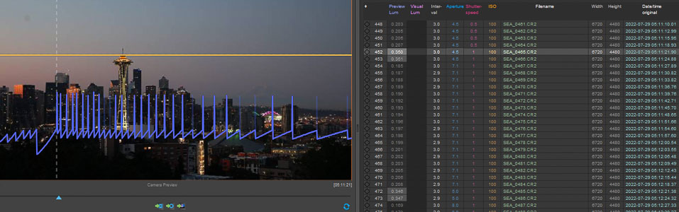

LRTimelapse shows these shutter jumps,

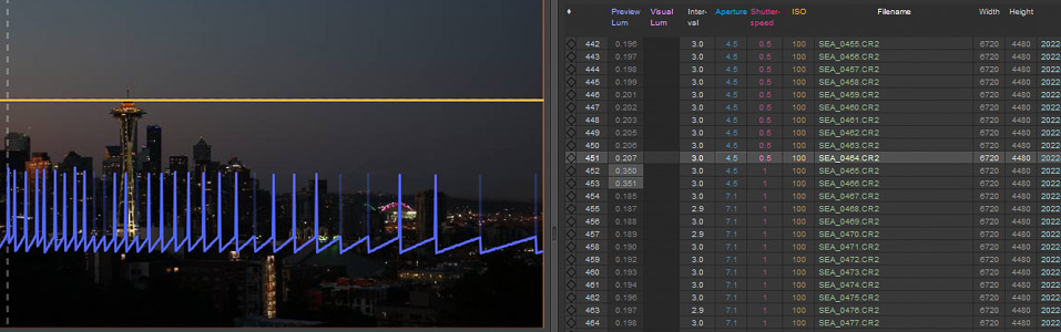

I actually see that your issues start here (pink circle) Where the Unleashed made too much of a correction. Could you send me the images for that range (including the first few jumps to the 1s shutter speed?) Or at least a screenshot where I can see the EV values for shutterspeed/aperture/iso for those images in LRTimelapse. That might help.

One thing that's really weird: the LRT algorithms are implemented that they can only make adjustments in one direction, so it's very odd that after the Shutterspeed jumps up to 1s, when really it should only ever adjust downward.

Here are the detail when the first sudden increase occurred,
From f4.5, 0.5 sec,
f4.5 0.5sec.jpg (93.34 KiB) Viewed 211727 times
to f4.5, 1sec,
f4.5 1sec.jpg (81.08 KiB) Viewed 211727 times
Why did the shutter go up to 1 sec? The initial shutter speed was set to 0.5sec for "Sunrise LRT modified beta". How does this has anything to do with interval (as you has suggested to test with a longer interval)?!

Hmm, that's very interesting. The drop from 2.8 looks like it's at the correct point in time (if you look at that sawtooth shape of the line, the vertical drop is pretty much where it's expected, but the odd thing is that it should have just been 1/3rd of a stop. instead it was 1.33 stops.
It then looks like that all those spikes are exactly that 1 stop (in the opposite direction.
