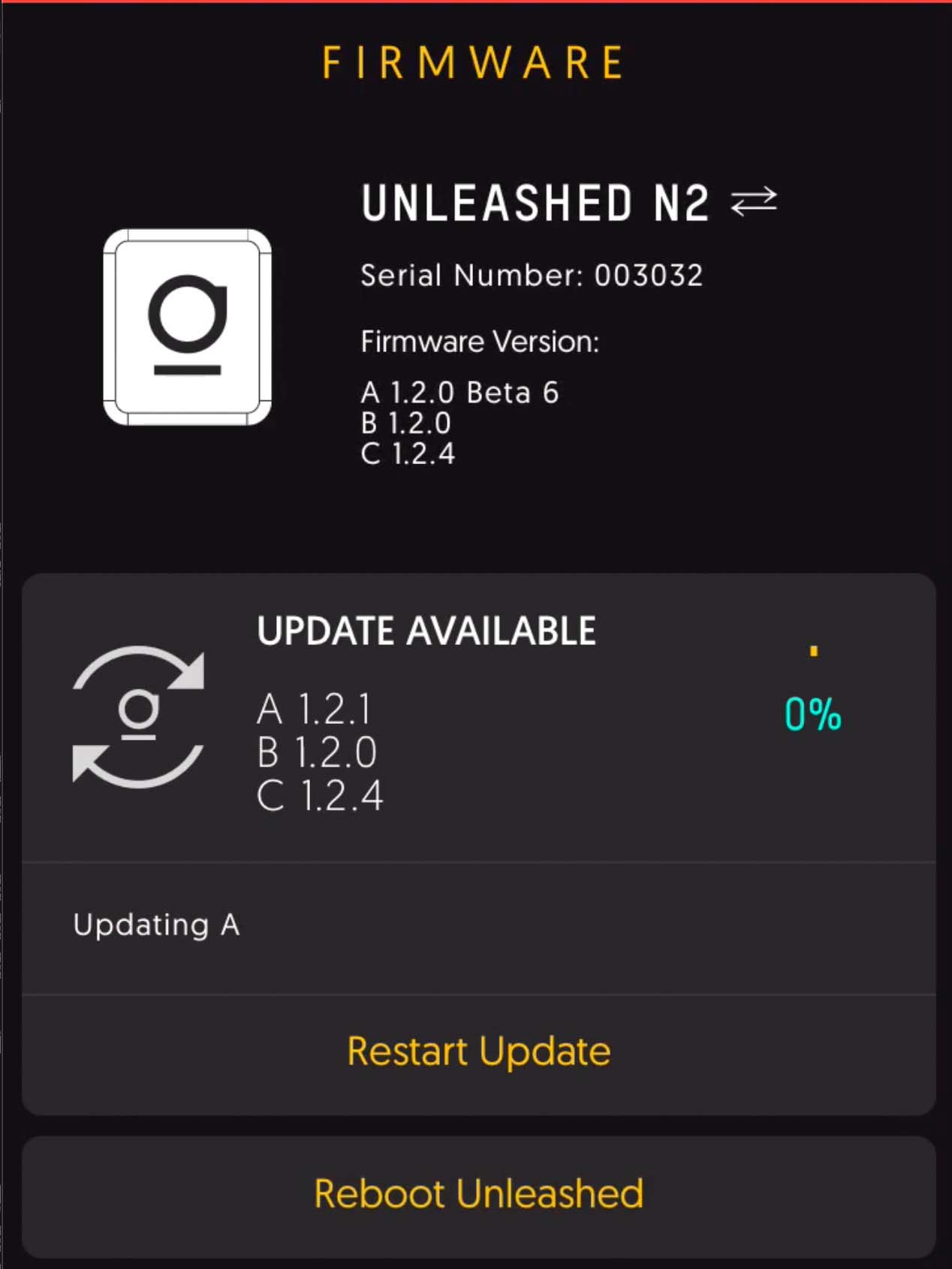

May 4th, 2019, 1:32 am
I do believe it's on the "A" upgrade. This is screen right before it fails...

May 14th, 2019, 3:46 pm
We finally found the issue that is causing the update A to fail on a few devices! We will be releasing another update in a few days that contains a workaround for the problem, and should allow you to finally get that update done!
It's taken us a long time to finally find that (very small) issue, since it only applied to a select few devices. Sorry for the long wait - we're almost there.

May 22nd, 2019, 12:01 pm
The firmware update does the update in the order C -> B -> A
So C and B were successful, but A is failing (the most common case)
Do give it a few tries, and hopefully it will work at some point.
