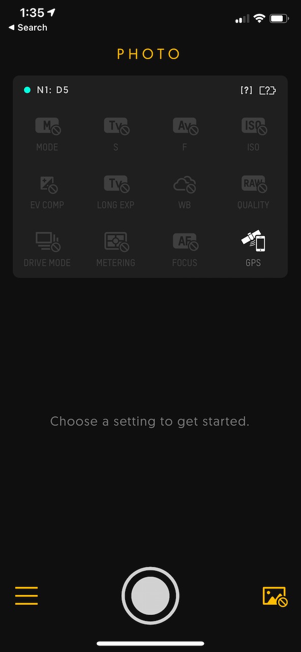

I am also seeing that the Unleashed is not properly showing the camera status in the iOS app (see attached screen shot).
I have once or twice been able to get things to work by unplugging then plugging the Unleashed back in, but then it stopped working again after a short time.

The image you attached is not visible in the forum message. Please add this as JPG attachment to the forum message, but make sure you use high compression (50%) to reduce filesize. The forum won't allow large filesizes. You could also use an external image hosting platform like https://imgbb.com/ or https://imgur.com/ for example, and reference your picture in this forum message if the image exceeds the max. filesize of this forum.

I have changed the screen shot from a link (which showed fine for me) to an embedded attachment.

slp wrote: I have changed the screen shot from a link (which showed fine for me) to an embedded attachment.
I do see the screenshot now also.
