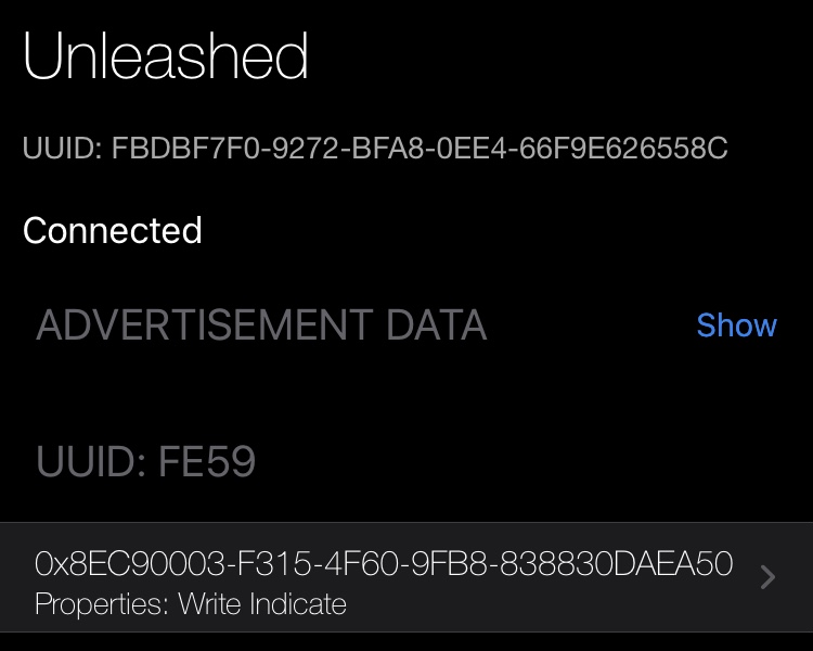

- Download a Bluetooth scanner app, such as LightBlue (icon looks like a fist, white/blue).
- Open it and look for a device called Unleashed (make sure that your Unleashed is plugged in the camera and the camera is on)
- Check if you see the following text at the top of the list (0x8EC90003-... as shown in the screenshot below)
If you see that text, we should be able to update your Unleashed, if you don't see it, we will have to replace it for you, unfortunately.

Hello Andy,
I did as recommended on Android with Bluetooth additionally enabled and disabled on the D780 (= same results) and this is how it looks with LightBlue.
Image Image
Image Image
I look forward to feedback from the specialist. I am not one.

December 21st, 2020, 9:16 pm
I'm afraid it doesn't look good, I would advise you to contact support@foolography.com and follow up there to see what can be done to get you a fully functioning Unleashed. Sorry that I don't have better news.
December 21st, 2020, 9:18 pm
Are there more things below what you showed in those screenshots? As far as I understand your Unleashed does "work" right? But you're unable to perform a firmware update?

Yes there are many more entries below.
I can at least trigger it via the app. Due to the missing cable, I can't test it any further. Because of the impossibility to update the firmware I turned to this forum.
