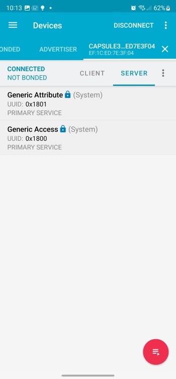

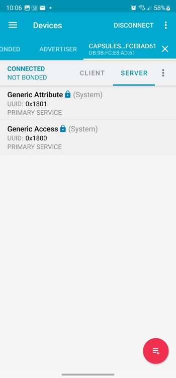

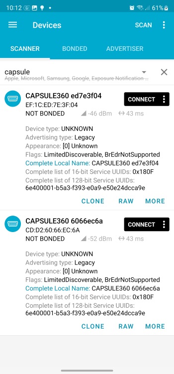

the nRF Connect output for the Capsule360 and the slider+
Screenshot_20231027_100856_nRF Connect.jpg (52.14 KiB) Viewed 86842 times
Screenshot_20231027_100627_nRF Connect.jpg (35.39 KiB) Viewed 86842 times
Screenshot_20231027_100621_nRF Connect.jpg (54.91 KiB) Viewed 86842 times

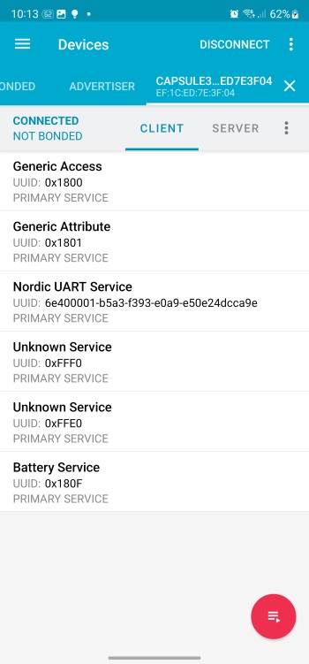

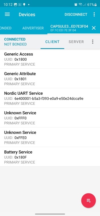

image 4-6
Screenshot_20231027_101234_nRF Connect.jpg (35.26 KiB) Viewed 86841 times
Screenshot_20231027_101222_nRF Connect.jpg (54.88 KiB) Viewed 86841 times
Screenshot_20231027_101208_nRF Connect.jpg (85.71 KiB) Viewed 86841 times

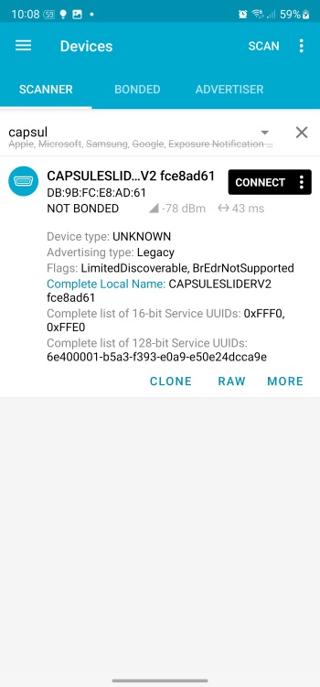

image 7-8
Screenshot_20231027_101320_nRF Connect.jpg (35.3 KiB) Viewed 86841 times
Screenshot_20231027_101313_nRF Connect.jpg (54.93 KiB) Viewed 86841 times
November 5th, 2023, 1:11 am
Haha,
thanks for the info ;-)
But unfortunately this shows us that they're using a single characteristic (Nordic UART Service) and will certainly have a proprietary protocol running over that. That will be a lot of effort to reverse engineer.
