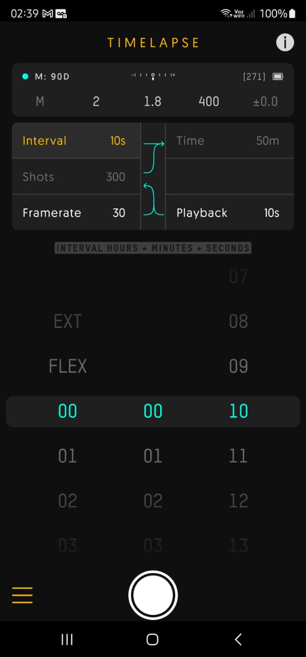

I had the same problem after the firmware update with my Canon 90D, interval was greyed out no matter what option I chose for interval.
I went around this by resetting factory settings.
It might work for you as well.

- WhatsApp Image 2023-12-03 at 02.39.40.jpeg (31.98 KiB) Viewed 66858 times

Yes, this is a problem introduced with the last Android app update.
I'ts in our list of known bugs: viewtopic.php?f=13&t=1904, along with a temprorary solution until the next update that will fix this:
Sometimes, after the upgrade to 3.1.0, the timelapse arrows might be in a weird state that shouldn't be allowed.
- This only happens if you had changed these to a specific value before updating, and the new version loaded this previously set value, but interpreted it differently. This is already fixed in the next update, but if you encounter it, simply change both arrows to another value, then back to what you want, and it will be solved.
