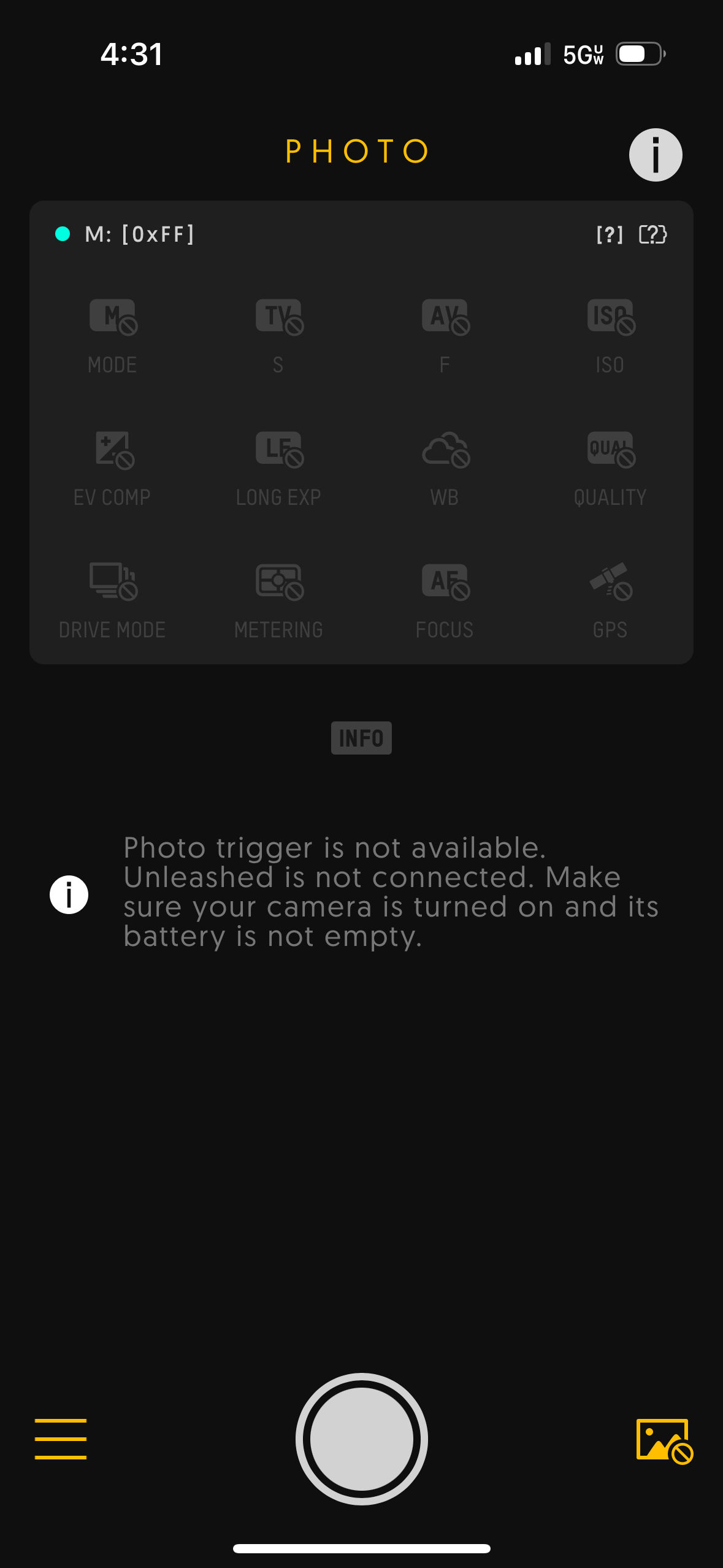

No lights, nada when paired to the usb port (I can power my Sony ZV-1 via USB and transfer data normally, so the USB port is working)
When I attached the supplied cable to the HDMI port of the ZV-1 I was able to power the device and subsequently pair with it, but it just stated that the USB port was not active.

Please have a look at our https://www.foolography.com/start page, to see how to best set up your Sony, as it can be set to very different USB modes. It needs to be on PC Remote to work with the Unleashed for most use cases.
Please also update your firmware, as we have added a feature that should get the app to tell you how to set up the camera's USB mode if it's not correct.
Lastly, yes, it could also be your USB plug. Rotate it a couple of times while it's connected to the Unleashed, to clean off the contacts. Hopefully that will do the trick.

I updated my Japanese ZV1 to the new 2.01 firmware and turned off a “smartphone” toggle that seemed to be blocking the PC remote function. Post that, updated the Unleashed firmware and everything is working properly now.
